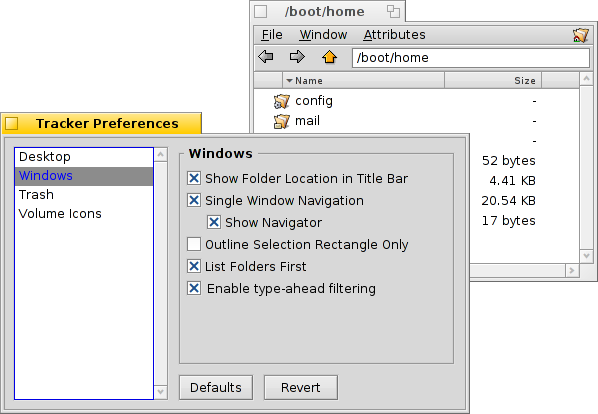

Préférences du Tracker
Voici les quelques réglages qui peuvent vous paraître obscurs :
(Bureau) - Indique si les disques montés apparaîtront sur le Bureau ou dans une fenêtre accessible via une icône Disks du Bureau.
OPT key, as described above, because you'll lose the per window saved position and size.
- You can set , i.e. a double-clicked folder doesn't open in its own window, but inside the already open window instead, replacing the view of its parent folder. This is not the same as clicking while holding theBefore you switch Tracker to
, because that may feel more familiar to you, we recommend giving the menu based browsing a try first, as that may actually work much faster for you after getting used to. On the other hand, single window browsing offers a Navigator where you can enter or copy & paste a path name and use back, forward and up buttons.Activating above.
will filter the contents of a Tracker window while you type to only display the files matching your string in their name or any currently displayed attribute. Seeand you won't see files starting with a ".", a popular naming convention for configuration files under Linux.
You can
which will replace the standard icons for image files.(Icônes des volumes) - Réglez la couleur d’un éventuel indicateur d’espace libre qui peut être affiché sur chaque icône de disque.
