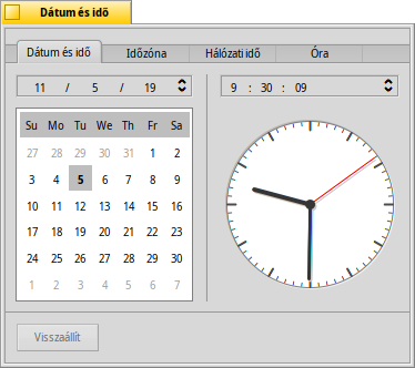

index Dátum és idő
A bal oldalon a hónap napja állítható be. Egyszerűen csak az adott napra kell kattintani a naptárban. Az év és a hónap a le/fel nyilakra kattintva, vagy billentyűzettel adható meg.
Similarly, you set the time at the right. Or simply move the hands of the clock directly.

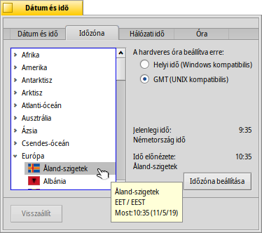

index Időzóna
Simply find and choose your country in the list of continents and press Set time zone. For countries with more than one time zone you'll have to expand one level deeper.
To the right you'll find the time of the currently set time zone and the preview time of the the zone you've chosen.
Also on the right side is a setting for the hardware clock of your computer. There are two modes for the clock:
Helyi időto display your local time, which you normally want if you dual-boot into Windows.
GMTto display Greenwich Mean Time, which is the UNIX compatible setting.

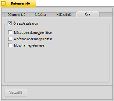

index Óra
The last tab shows the options of the clock displayed in the Deskbar. You can disable the clock there completely with the top checkbox. The rest are equally self-explanatory.
In every tab is a button Revert that brings back the settings that were active when you started the Time preferences.
